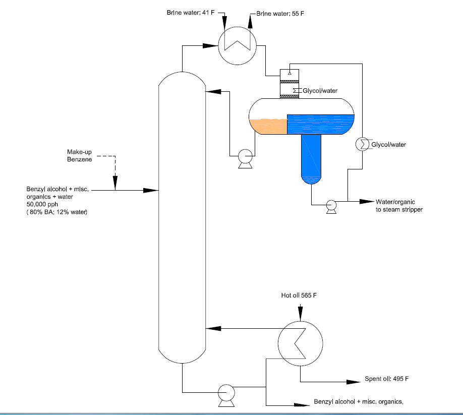

Our azeotropic distillation column serves as the first step in separating water from benzyl alcohol (Figure 1). Unfortunately, this trayed tower suffers periodic hiccups; flooding occurs, causing an off-specification bottom stream.
Initially, production tried boosting the reboiler temperature to reduce the periodic flooding. This led to condenser loading problems and high pressure in the condenser decanter that raises concerns about popping our pressure relief valve.
We looked at the feedstock for water contaminations. One operator suggested that the decanter is too small.
Another brainstorming session produced the idea of adding a feed preheater to vaporize the feed. The column designer says this is a bad idea. He warns it would increase the load on downstream columns because of more alcohol in the condensate. He suggests running a gamma back-scanner to determine where liquid is accumulating in the tower. His boss recommends a neutron back-scanner because of insulation.
What do you think is causing the problem? What tools should we use to determine the flooding tray(s)? What ideas do you have on how to address the periodic flooding?
