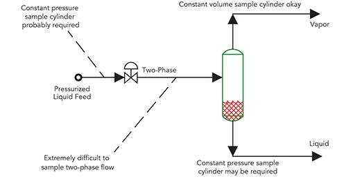

When using constant volume sampling, a significant pressure drop can occur across the inlet valve. Consider the situation with a separator drum (Figure 1). Attempting to take a constant volume sample of the drum feed, if it’s a pressurized liquid, may result in flashing across the cylinder inlet valve and, thus, two-phase flow going through the cylinder. In such a case, possible liquid/gas phase separation likely will render the sample unrepresentative. In addition, the laboratory will find the sample very difficult to handle.

Figure 1. Flashing due to pressure drop across the inlet valve may lead to an unrepresentative sample.
One solution is to take samples of the streams downstream of the drum and then use separate analyses of the gas and liquid samples along with their flowrates to calculate the feed composition.
The gas sample is relatively straightforward. However, the downstream liquid still may flash — you may not have prevented the problem, just moved where it arises.
If you’re dealing with a hot system, using a sample cooler on the liquid may drop the temperature enough to prevent flashing. This enables a constant volume cylinder to sample correctly.
Temperature drops during sampling can create their own problems for both gas and flashing liquid sampling. In some systems, the pressure drop across the inlet valve can lower temperature significantly. With sufficient moisture present, the cylinder valves may freeze open.
One solution to these sampling difficulties is to use a constant pressure cylinder. This type of cylinder has an internal piston. A fluid acting on one side of the piston raises the pressure to that of the sampling system. The cylinder is attached to the process and the valves are opened; then the pressurizing fluid is gradually released until the cylinder is full. This type of approach would work for sampling the upstream liquid as well as the downstream liquid. The pressurizing fluid often is nitrogen or another gas inert to the process that doesn’t affect the analysis if it leaks into the sample.
