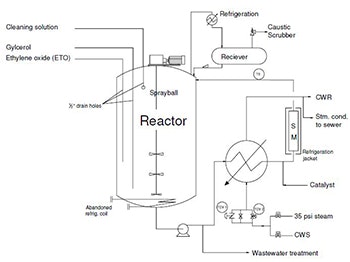

Our ethylene oxide (EtO) batch reactor (Figure 1) suffered an explosion one Saturday morning. The reactor was filled with glycerol before EtO feeding began. A steam-heated exchanger raised the temperature of the reactor to 240°F. The pressure spiked suddenly when the EtO addition started; the operator had been taught that meant the EtO wasn’t reacting. The reactor had been cleaned the night before with water and caustic.
Ethylene Oxide Reactor
Figure 1. Significant damage occurred after opening the steam block valve.
The shift supervisor authorized the operator to raise the trip point to 400°F and to continue to heat the reactor. The supervisor, who had experience in a similar process where the temperature sensors became fouled and insulated, didn’t trust the temperature reading. Besides, the night foreman had steamed the purge nitrogen in the insulated reactor a half hour before glycerol was added; this isn’t part of the cleaning procedure, just something operators have done for years.
Recent changes in the control system faceplate weren’t fully understood yet. The operator, confused by the labels for the cooling and heating block valves (that feed the temperature control valve), decided to take a walk outside. The faceplate didn’t indicate the pump was circulating through the heat exchanger and catalyst bed all along, which the operator confirmed in the field. However, instead of finding the cooling water valve open and the steam valve closed as expected, both valves were closed. The supervisor ordered the operator to open the steam block valve; the reactor relief valve blew but not before two flanges on the reactor split, damaging the reactor and sending parts of the top reactor pipe flying.
After the accident, the new supervisor blamed the operator for opening the valve. An inspection of the reactor also showed suspicious holes near the top of the reactor in the dip tubes for the caustic, glycerol and EtO.
The superintendent, who wasn’t aware the reactor contained an abandoned refrigeration coil, blamed it for the incident, saying a hole allowed caustic to collect in the coil and that the caustic leaked out and led to a pressure spike when the EtO reacted with it. The superintendent asked a retired operator who knew about the coil and the dip tubes why the caustic never caused this problem before. That person responded that in the past the reactor was flushed by hot water before being purged and dried. Cutback in inert gas usage and limits on water consumption led to recent changes in the cleaning sequence.
What do you think the root cause of the incident was? Could we have prevented this accident?
