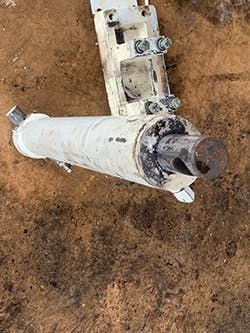

A fixed or variable displacement pump supplies fluid (usually a hydraulic oil) that acts on a component like a cylinder (Figure 1) in the hydraulic circuit to do the assigned work. Typically, a gear, vane or piston pump handles this duty, with the choice depending on operational requirements, performance and budget. Usually, the system should have two pumps, one operating and another on standby.

Figure 1. This heavy-duty double-acting unit awaits repair and refurbishment.
