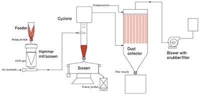

I am a new graduate now working as a production engineer at an extrusion plastic manufacturer and would like to make a good start. I manage a process to produce paint pigments and would welcome some tips on optimizing the operation (Figure 1).
A Fine Mess
Figure 1. Clogging of nozzles as well as potential environmental issues cause concern.
From what I’ve gathered in a few weeks, we have bouts of clogging in the paint spray nozzles at the extruder. We also see far more fines in the screen than corporate engineering considers appropriate. We change bags every couple of weeks, which seems too often; the bags are tossed in drums as toxic waste.
Laboratory results show a lot of dust collected on the coarse product. Dust sometimes appears to get through the baghouse to the blower. I see dust on the duct connections to the blower and at the outlet to the atmosphere. One operator complained that dust clogs the product container nozzle of the grind collected at the screen.
I talked to several managers and engineers. The production manager said not to worry about it because the plant always has run this way. Someone in corporate engineering suggested digging through the files, hinting this wasn’t the first design for the system. The plant safety manager isn’t worried about the dust but the corporate manager is concerned because exposure to this pigment is a problem in Europe.
Can you suggest anything I should look at to reduce downtime and improve product quality?
