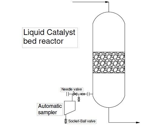

We installed a new automatic sampler in our catalyst bed reactor (see Figure 1). It replaced an old corroded manual station that was fouling. The manual station worked but some of our new operators warned it posed a burn risk; veteran operators had developed a knack for avoiding that risk. So, the safety department mandated putting in an automatic sampler.
Figure 1. Operations complains the blowdown procedure now used is both unsafe and messy.
The sampler manufacturer insisted on the installation of a Y-strainer but the pipe layout didn’t have space for one. Our project engineer downplayed the need because the sampler had a built-in strainer; he had a drain valve installed to blow nitrogen into the strainer to clean it.
I checked the boneyard and the old station had a Y-strainer but, on closer examination, the screen was corroded with extra holes in it. I noted that someone had welded a finer mesh into the strainer.
The constructor installed the ball valve at the inlet but the vendor insisted on a needle valve.
Quality control is complaining that the sampler results are erratic. Operations doesn’t like the blowdown procedure, saying it’s unsafe and messy; an operator already has been hurt when his safety glasses were blown off his face. We’re blowing down the sampler twice a shift. Blowing down doesn’t help as much as expected; operators still have to rod out the inlet piping.
What can I do to improve operation of the automatic sampler? How can we improve safety? What do you think?
