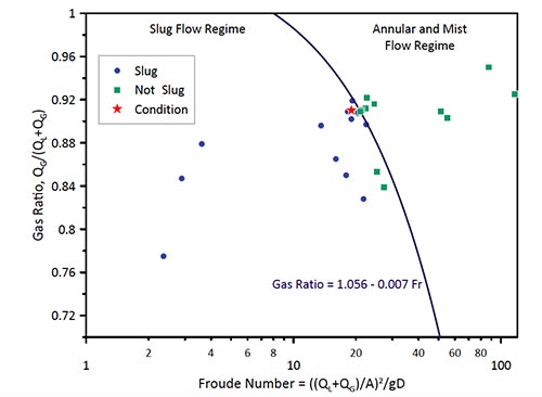

A plant temporarily had reduced rates. This resulted in pipe shaking and vibration severe enough to raise concerns about equipment damage and safety. The suspected cause of the shaking was slug flow in a vertical line from a condenser (at grade) to a drum above it. Attention immediately turned to how to reduce the shaking and vibration.

Options for alleviating the problem depend upon how far away the operation is from a transition point from slug flow to a more-stable flow pattern. Different correlations and flow maps often offer disparate answers. Here, five correlations gave three contrasting answers on expected flow regimes. Why is this?

Figure 1. Location of operating point of problem system (shown by star) indicated a small amount of inert gas would stop slug flow.
Figure 1 shows a section of the Griffith-Wallis flow map for a narrow gas-ratio range (~0.75–0.96) based on volumetric flow ratios versus Froude number. (As long as consistent units are used, both axes are dimensionless numbers.) The original correlation was based on a mix of data in small pipes (0.5–1.0 in.). However, data from commercial units (6–8-in. pipes) with hydrocarbons have been added. The data were a very good fit of gas ratio versus Froude number.
In the figure, a star shows the operating point of the problem system; it is very close to the transition line. Because higher-volume gas flows move the operating point up and to the right, injecting a small amount of inert gas into the system eliminated the slugging problem. This injection ended once normal operating rates were re-established.
This map seems a good fit here — but its applicability may not extrapolate to other conditions.
Numerous elements, including pressure drop, void volume, and slug size, play a role in two-phase flow that may be important in specific situations. In this case, understanding of flow regime sufficed to stop the slug flow.
