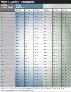

Standards for each general-purpose rating (subtype I) from 1 to 200 hp. previously covered by EPAct increase to the nominal full-load efficiency level for "NEMA Premium" given in Table 12-12 in NEMA "Motors and Generators," Revision 1 (MG 1 - 2009) — see Table 1. (For more information on the standards, go to www.nema.org/stds/mg1.cfm.) These are 230/460-V., 60-Hz., Design B, 2-, 4- or 6-pole AC induction motors.

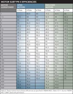

General-purpose electric motors (subtype II) previously not covered by EPAct must meet efficiencies defined in Table 12-11 in MG 1 (Table 2). These motors incorporate design elements of a subtype-I general-purpose unit but are configured as one of the following:
• U-frame motor;
• Design C motor;
• close-coupled pump motor;
• C-face or D-flange footless motor;
• vertical solid-shaft normal thrust motor (as tested in a horizontal configuration);
• an eight-pole motor (900 rpm);
• a poly-phase motor of not more than 600 V. (other than 230 or 460 V.); and
• 201–500-hp. motors previously not covered by EPAct.
EISA-mandated efficiency levels for subtype-I motors fall within efficiencies of existing general-purpose 1–200-hp. NEMA Premium efficient motors, such as Baldor's Super-E.
Motor Subtype I Efficiencies
Table 1. All such motors must meet NEMA Premium efficiency as specified in NEMA MG1, Table 12-12. Source: NEMA MG 1-2009. Used with permission.
Manufacturers of some designs of subtype-II 1–200-hp. and general-purpose 201–500-hp. motors may have to raise their efficiency; however, many designs may already comply. NEMA Premium efficient motors meet or exceed EISA requirements for either of these motor types.

Motor Subtype II Efficiencies
Table 2. These motors must achieve efficiencies as specified in NEMA MG1, Table 12-11. Source: NEMA MG 1-2009. Used with permission.
