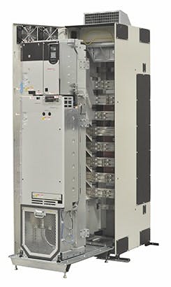

Low-Voltage Drive
Figure 1. Online tool now provides information on the energy efficiency of this and other drives in the same series. Source: Rockwell Automation.
Better Decision-Making
For its part, Rockwell Automation provides an online ECO Tool for finding energy efficiency details of its Allen-Bradley line of LVDs (Figure 1). Today, the tool now supports PowerFlex 750 series drives; coverage of additional lines of PowerFlex drives will follow in the future.
