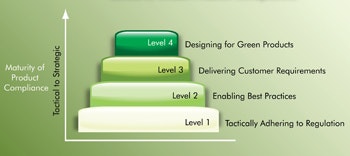

The strategic approach (Figure 1) is designing for sustainable products. This means checking for compliance early and often. Regulatory data are a necessary component in all operations including product lifecycle management, supply chain management, order management, sales and operations, as well as government, risk and compliance activities. Product compliance must be integrated into business processes, best practices and information management systems.
