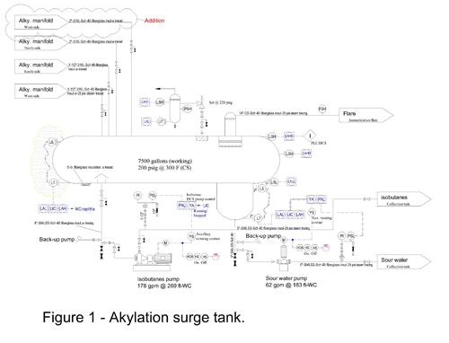

Our refinery suffered an incident that nearly led to a fire. It occurred after the board operator started the isobutanes pump on an alkylation unit surge tank (see Figure 1). The pressure safety valve popped, the flow switch in the vent tripped and so did the unit interlock on the high-high level switch.
This happened while a field operator was busy walking down one of the alkylation towers looking for leaks. That operator remembers the light on the pump station being off and assumed the low-level switch stopped the pump.
I work in a different part of the refinery and have been assigned to investigate the incident. I found the hand-operated actuator set to “off” instead of “hand” as the field operator was instructed. The display in the control room is supposed to show the pump in gray when it’s in off or hand mode to indicate that the board operator isn’t in control of the pump; the board operator doesn’t recall it being gray.
This problem involves a larger issue, though. Both the board and field operator don’t trust the automatic controls: the dP level transmitter always reads high. The board operator has compiled rough records of level based on flow meters that indicate a disparity. During the last turnaround, two years ago, the operator complained that he and the instrument technician thought the dP’s dry leg (upper) element was in the wrong place. Nothing was done then — our refinery was bought by an investment bank four years ago and maintenance has gone downhill — and the tech doesn’t work at the site anymore.
So, the board operator relies on alarms from the high and low level switches — and gets the field operator to manually shut off the pump in the case of a low-limit-level warning.
Both operators had complained to their new supervisor about the problem and were told it would be addressed during a turnaround in six weeks.
Now, rumor has it the superintendent is blaming the field operator for not being more careful.
I don’t want to rub the superintendent the wrong way; he’s politically powerful. How should I approach this problem? What do you think the root cause of this incident was?
