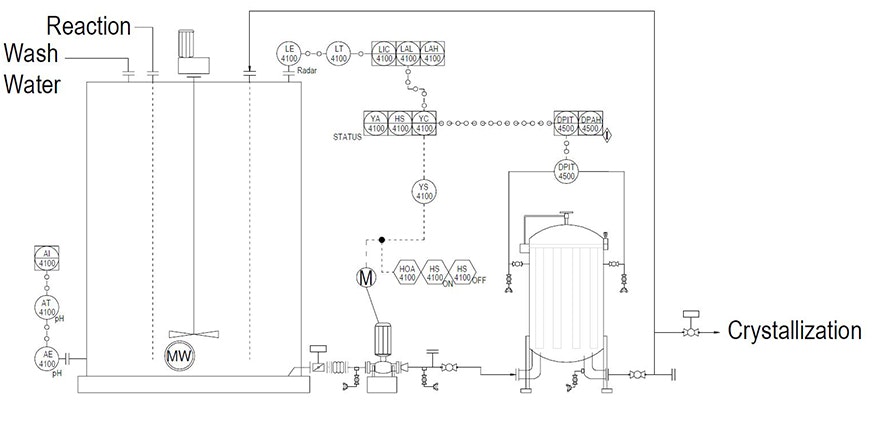

The filtration process for liquor leaving a treatment tank at my plant continues to plague us, despite a variety of changes made in the over a decade I’ve been there. It’s now of particular concern to me because I’ve worked my way up from operator to operations superintendent.
Filtration System
Figure 1. Liquor goes from a treatment tank to a sock filter before passing to recovery operations.
We started out with a crude filter but went to a cartridge filter, then to a filter press and now to a sock filter (see Figure 1). Corporate ditched the cartridge filter because the dirty cartridges added to our landfill, and soured on the press because it broke down a lot. A large horizontal pump provided the high pressure we required; that pump hardly ever fouled, although we deadheaded it a lot. We relocated the pH probe from the pump discharge to the treatment tank to ease access for maintenance. The old agitator in the tank was a 45° axial impeller but was replaced with a high-efficiency impeller to increase up/down flow. Corporate also swapped out the old level transmitter — a dP bubbler with a third tube to adjust for density, whose tubes typically fouled at the bottom well before our annual outage — with a radar gauge. It is great except when we steam the tank between batches to help clean the tank; then, we get a lot of high alarms.
The sock filter is a slight improvement over the filter press but takes up a huge amount of real estate. In addition, it poses some operational issues. We must use a lift to get the cages out of the housing; removing the solids is messy and a fire hazard. Corporate had promised that we wouldn’t have to change socks as often as we actually must and that it would be easier than cleaning the filter press. My quality engineer blames the problem on poor agitation in the tank.
How should I approach corporate to reduce the downtime and improve quality control in the process?
