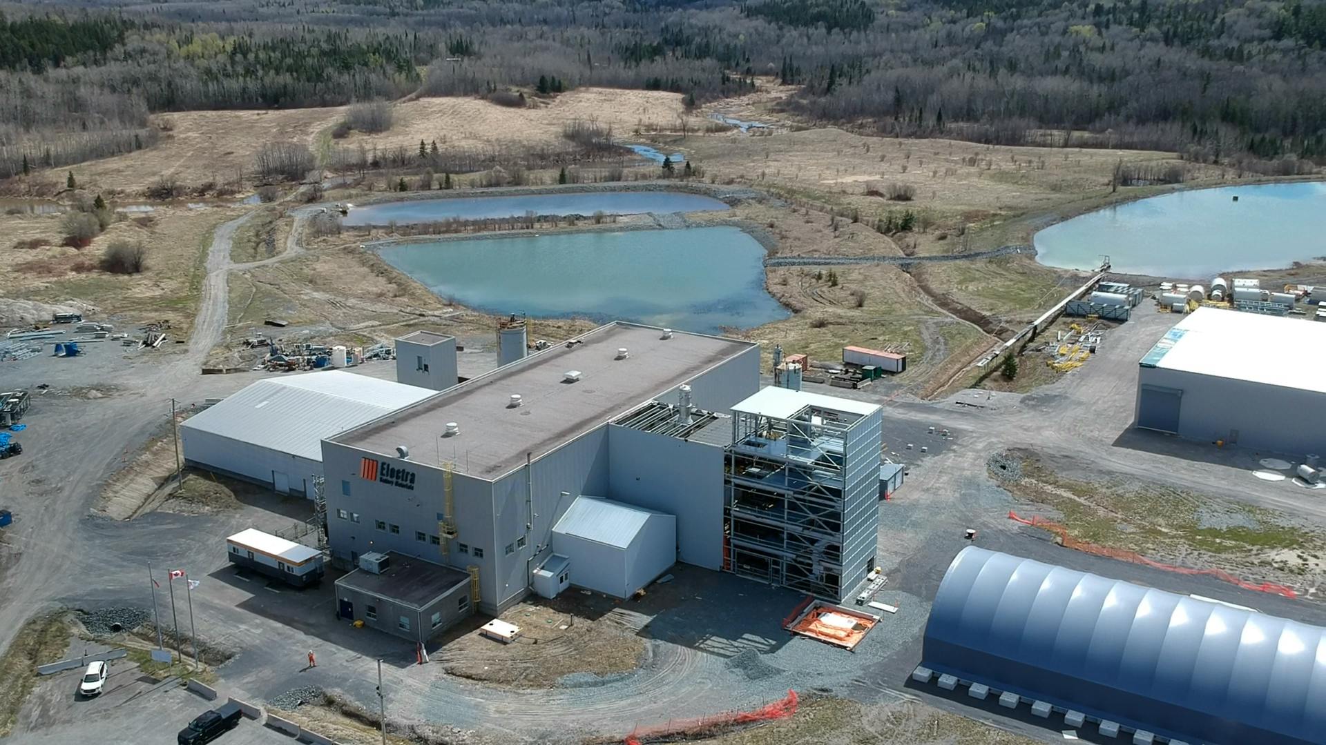

Electra Battery Materials said Oct. 26 that construction of its cobalt sulfate refinery in Temiskaming Shores, Ontario, remains within its US$73 million budget as work advances from structural construction to equipment installation and commissioning preparation. The site workforce has grown to 130 people from approximately 60 in August.
Mechanical equipment is installed in the crystallization circuit, and structural steel installation and module alignment are complete in the solvent extraction building. Fiberglass-reinforced plastic (FRP) lamination of process equipment has begun, while electrical cable tray installation is nearing completion. Civil work for Phase II of the tailings storage facility is approximately 40% complete.
The company identified potential schedule pressure related to the fabrication and installation of FRP process piping in the solvent extraction area. Following the recent award of the piping contract, Electra is evaluating measures to accelerate the work. The company expects any schedule adjustment, if needed, to be modest.
Commissioning preparations are also advancing. Instrument validation is underway, laboratory analytical methods for certifying battery-grade cobalt sulfate have been developed, and work on the Rockwell Automation control system is progressing. Electra has engaged Metso for site advisory services through mechanical completion and commissioning, and is preparing a tender for commissioning services.
