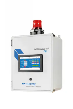

Gas and Flame Detection Controller Supports Scalable Monitoring
The MCX32-TP gas and flame detection controller from Teledyne Gas and Flame Detection is designed to monitor gas detection sensors and other field devices with scalable channel capacity. Standard configurations support 4, 16, 32 or 64 channels, with the architecture scalable to 128 channels.
The controller features a touchscreen HMI available in sizes from 5 to 15 in. for system configuration, real-time monitoring and alarm visualization. Communication options include Ethernet/IP, Modbus TCP and BACnet, along with MQTT and web-based remote access.
Dual LAN ports, multiple serial interfaces and modular I/O options support integration with existing plant infrastructure. The controller is available in standard or custom configurations with configurable enclosures and wireless integration capabilities.
The modular architecture allows the system to accommodate additional sensors and distributed assets as detection requirements change.
