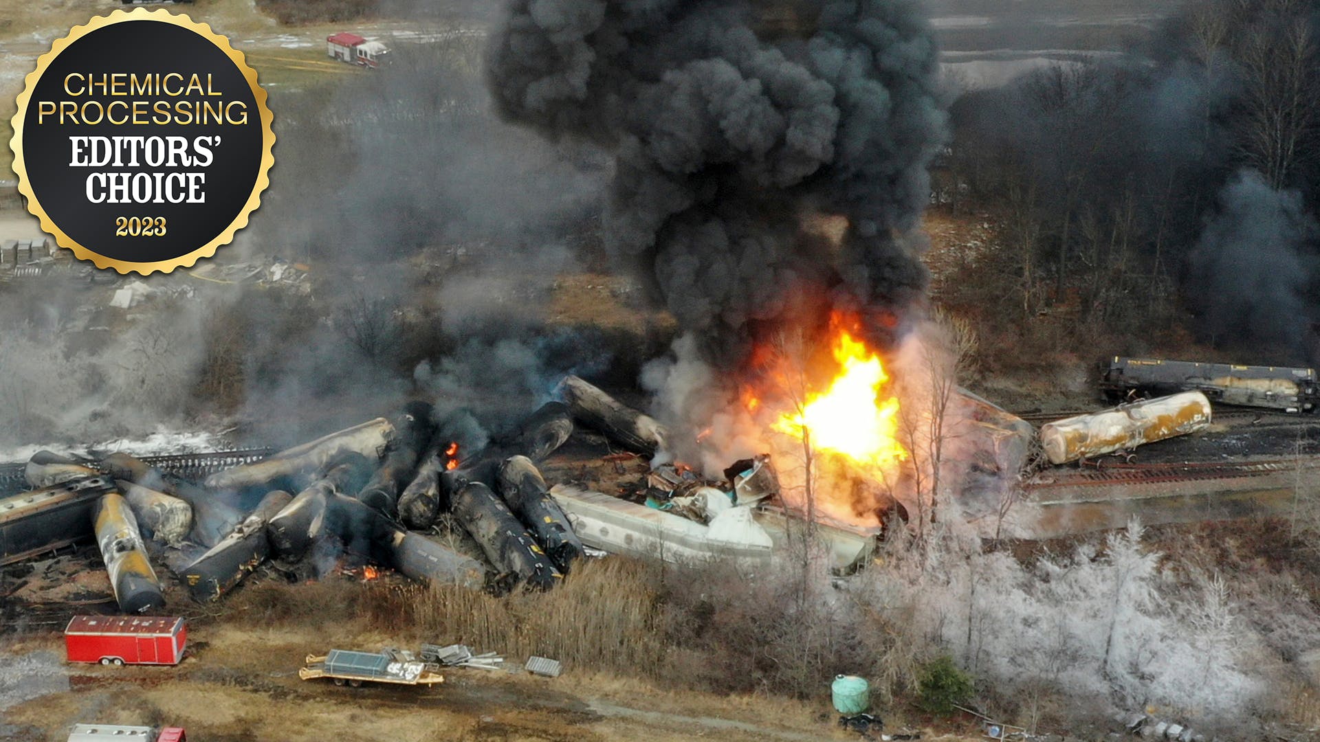

On March 9, senators on the Environment and Public Works Committee grilled Norfolk Southern CEO Alan Shaw over his company’s involvement in the East Palestine, Ohio, Feb. 3 train derailment and chemical spill. During his testimony, Shaw discussed steps Norfolk Southern would take to improve safety, including improvements to early-warning sensors and the development of a digital train inspection program. He also talked about partnering with other railroads to review best practices.
