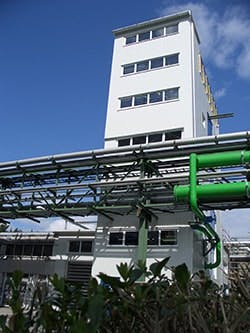

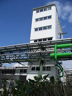

Dyneon GmbH’s pilot plant to recycle end-of-life fluoropolymer materials in Burgkirchen, Germany features a HIMatrix safety controller from Hima as the emergency shutdown (ESD) system. The system is designed to safeguard the plant’s depolymerization reactor. If excess temperatures are reached, the safety system transitions the plant to a safe status to exclude the possibility of risks for people and the environment, according to Hima.
Dyneon uses technology for treating wastes for the sustainable recovery of raw material at its new, high-temperature recycling plant. Through pyrolysis, the perfluorinated, end-of-life waste is broken down into monomers, with a recovery rate of more than 90 percent, according to Hima. The monomers are fed into the distillation system and can be used for the production of new fluoropolymers.
