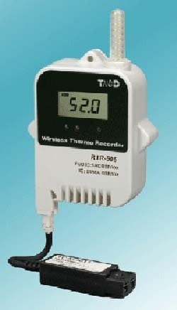

TanD Corp. has launched the RTR-505TC wireless data recorder, which can measure and record temperatures of -199 degrees to +1,300 degrees Celsius.
These new data recorders are compatible with J, K, S & T type thermocouples and accept industry standard miniature connectors. The RTR-505TC has 15 recording intervals from 1 second to 60 minutes and a capacity to store 16,000 readings.
Additional features include a large LCD display, IP64 water resistance and battery life up to four years with "L" version.
The units have a communication range up to 500 feet, which is extendable with a repeater. They are compatible with all TandD RTR-500 series wireless data collectors, which allow for data retrieval to a PC, over a network or the Internet, or through a cellular phone system.
