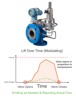

A pilot‑operated valve solution with a DP transmitter provides the highest‑fidelity measurement, making it best suited for higher‑capacity or critical service valves. By continuously capturing valve travel throughout the release event—and modulating it with system pressure—this solution provides the data to create a lift‑over‑time profile that reflects real dynamic behavior, including partial openings and throttling. This enables more accurate determination of actual flow and emissions, aligning reported values closely with true process conditions, rather than assumed full‑lift scenarios (Figure 3, Best approach).
Because pilot-operated valves inherently modulate in response to system pressure, the resulting lift-over-time profile reflects how the valve dynamically adjusts during relief, including partial openings and throttling behavior. This continuous modulation enables a more precise determination of actual flow throughout the event, allowing emissions to be quantified based on real valve response rather than assumed full-lift conditions. As a result, reported emissions more accurately reflect true process conditions and are aligned closely with actual release volumes.
Together, these visualizations highlight the distinction between detecting that a relief event occurred and understanding how the valve physically responded during that event, an increasingly important consideration for HON and other regulatory compliance.

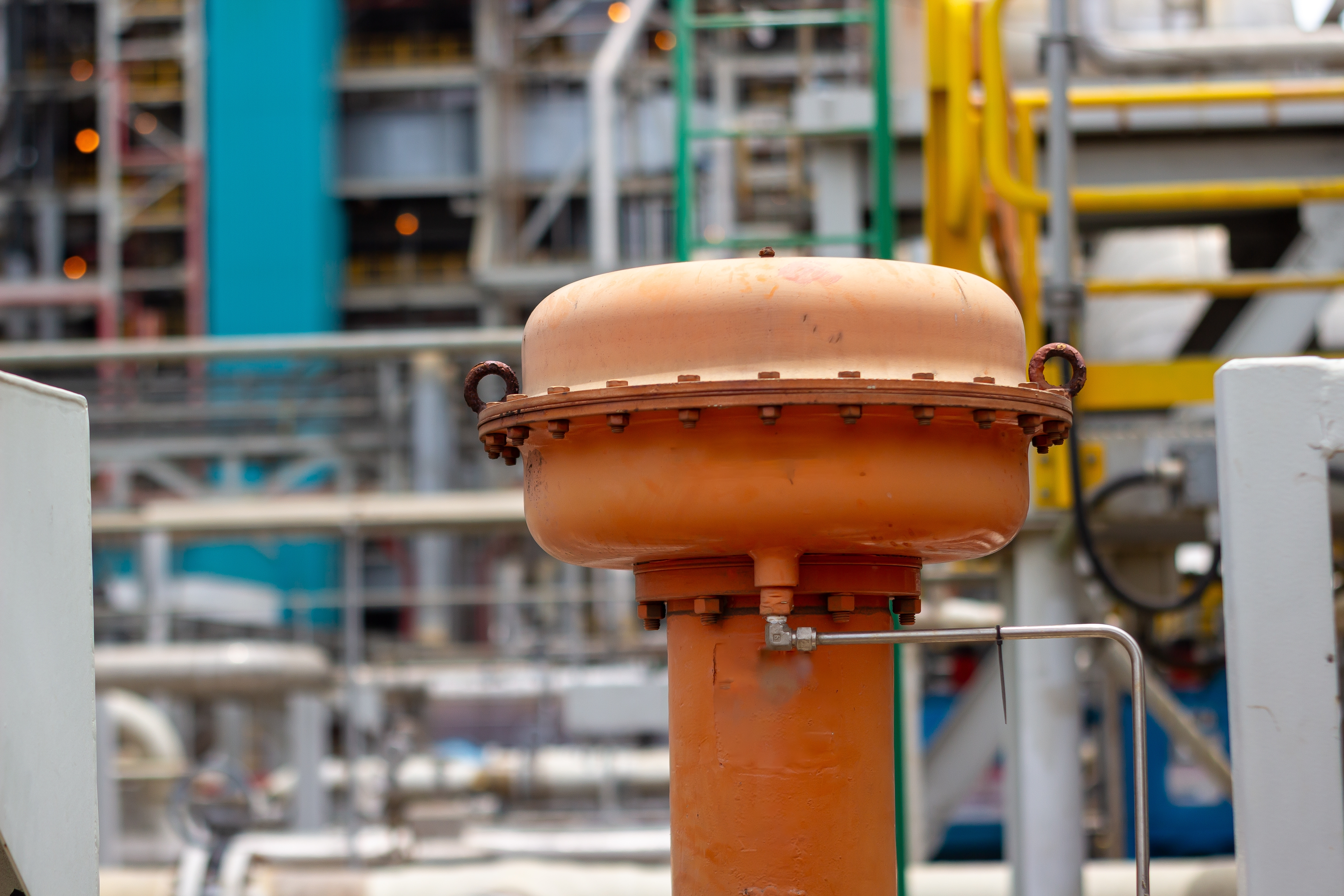

This distinction became central for a large chemical manufacturing facility preparing for HON compliance of its ethylene oxide unit (Figure 4). The site needed to improve PRV monitoring to meet upcoming regulatory requirements, but it initially did not have clarity on which approach would best support accurate and defensible emissions reporting.
Historically, the facility relied on periodic inspections and inferred indicators to assess PRV activity. As HON requirements came into focus, it became clear that this approach alone would introduce uncertainty into emissions documentation and potentially lead to conservative reporting assumptions. To address this issue, the site began evaluating monitoring options with a focus on improving accuracy, transparency and long‑term regulatory confidence.
Both limit switch and direct valve position monitoring were considered as part of this assessment, particularly given that most of the installed base consisted of direct spring PRVs. Through technical review and demonstration of valve behavior under simulated relief conditions, the facility gained a clearer understanding of how each method characterized emissions events. Seeing valve lift represented over time, rather than inferred from event duration alone, helped clarify how the monitoring strategy directly influenced reported emissions.
