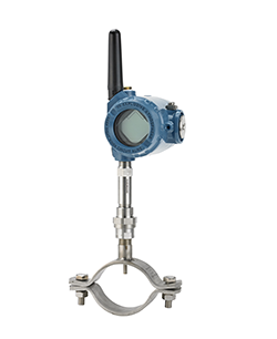

Emerson Process Management introduces Rosemount X-well Technology, a surface sensing temperature measurement solution that eliminates the need for thermowell process penetration when measuring process temperatures in pipe applications. The technology provides an accurate and repeatable internal process temperature measurement, while eliminating possible leak points and simplifying specification, installation and maintenance, according to the company
Rosemount X-well Technology is available in the Rosemount 648 Wireless Temperature Transmitter and Rosemount 0085 Pipe Clamp Sensor Assembly. These components work together to calculate process temperature via the transmitter’s thermal conductivity algorithm. Rosemount X‐well Technology works by measuring the pipe surface temperature and ambient temperature, and combining this information with an understanding of the thermal conductivity properties of the installation and process piping.
Rosemount X-well Technology offers accurate process temperature measurement without requiring any intrusions or penetrations into the process, allowing quicker and easier installation along with simplified long-term maintenance, according to the company. Users do not have to design, size or maintain thermowells. Wake frequency calculations are eliminated, as well as time spent determining material compatibility, the right insertion length and the necessary profile.
With Rosemount X-well Technology, users can also add temperature measurement points without having to shut down a process. X-well Technology can be installed with a standard pipe clamp procedure and ordinary hand tools, and does not require a skilled contractor. Applications include pipelines, high velocity flows, slurries, heavy particulate fluids, wellheads, clean-in-place processes, high viscosity fluids and harsh processes in the oil and gas, chemical, refining, food and beverage, metals and mining and pulp and paper industries.
