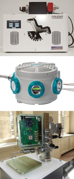

COMPACT CHROMATOGRAPHS
Figure 2. Small-format gas chromatographs now are available from a number of vendors. Sources: APIX, Falcon, Siemens.
Remember that one of our purposes in placing the NeSSI components on-line is to improve response time. Spectroscopy already is faster than most process control systems are set to react, but GC historically has been much slower. So, we'll focus on how the interplay between NeSSI and gas chromatography is helping address this issue.REFINING GAS CHROMATOGRAPHYOver the last ten years, a substantial effort has focused on making on-line GC more responsive to the control world. Throughout, the goals have been to:• speed the response time;• reduce an on-line chromatograph's footprint; and• better utilize computational advances to extract the information content of the data stream.Ultimately, we want to turn a process GC into an appliance. As we work to attain this goal, some fundamental changes are needed both in our approach to hardware and the scope of the software.With the advent of NeSSI fluid handling and a standardization of the sampling approach to the process stream, the trend clearly is toward making the instrument smaller as well. Today, a number of compact and even micro GCs are available (Figure 2).Some portions of a gas chromatograph are amenable to shrinkage but, ultimately, there's a tradeoff between the number of applications that can be handled and the system dimensions. So, we need to adopt a Goldilocks approach — i.e., selecting an instrument that's just right. With the advent of direct on-column heating, we can eliminate the largest source of power consumption and weight, the chromatographic oven. This excises well over half the weight and 75% of the size. Also, by removing the oven from the design, we gain flexibility in analyzer placement. We often can get away with abandoning an air-conditioned near-line structure in favor of a simple sun- and-rain shield, allowing system positioning much closer to the sampling point. Ultimately, this oven-free approach simplifies maintenance requirements because we need to tend shorter supply lines. Then, by requiring the system to be a series of plug-and-play modules, we turn the maintenance visit into one measured in times of five minutes or less rather than hours.

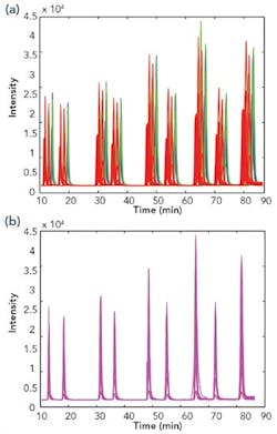

ALIGNMENT VARIABILITY
Figure 3. Over a 5-yr period, six different GCs produced these raw chromatograms (a) but software gave aligned chromatograms (b). Source: Chevron ETC.
Hydrogen carrier gas and short, high-resolution capillary columns cut the time of analysis, while detection system options (flame ionization for hydrocarbons, thermal conductivity for atmospheric components, flame photometric for sulfur compounds, and halogen-specific for environmentally significant components), coupled with NeSSI-smart valve injection, give us an extremely flexible base for analyzing nearly anything on-line in real time.The smaller form factor, better speed and lower maintenance demands show how the NeSSI concept has migrated to the instrument side to give us the fundamental basis for true control of a process. Now, let's turn our attention to software developments that NeSSI is fostering.ELIMINATING RETENTION TIME VARIABILITYA series of chromatograms will clearly show that retention times change as a function of time. This is even more evident when comparing instrument to instrument or before and after column maintenance (Figure 3a).It's not practical in a process setting to manually manipulate the chromatographic conditions to keep retention times constant. This leads to the first role for software: to adjust for retention time drift. A number of software techniques can address the problem; all use a multivariate correlation algorithm to bring the retention times under sufficient control, even when matching results from more than one chromatograph.Figure 3b shows that such software, in this case LineUp, allows us to generate consistent run-to-run results for more than one chromatograph and over a long period of time. This capability can impact maintenance — by reducing the time spent on instrument calibration. For instance, taking three similar chromatographs (same nominal method, column and detectors) fresh off the production line and applying the alignment technology, we should be able to superimpose the results, as shown in Figure 4.With alignment technology bundled into the method, the GC will generate very consistent results as long as mechanical problems, column degradation or a process upset don't intervene. So, we can get accurate, representative results every time, even if we must change a column, a detector or even an entire instrument. We also can monitor how hard the software must work to keep retention time under control — affording us a mechanism to predict and prioritize when a hardware problem must be addressed.

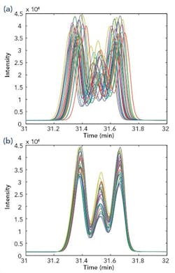

MULTIPLE INSTRUMENT ALIGNMENT
Figure 4. Before (a) and after (b) results show the impact of alignment software on three similar new GCs.
The effect on maintenance efficiency is clear. Industry analyses, e.g., Reference 2, indicate that a vast majority of trips to the analyzer location prove unnecessary and that the most common culprit in chromatographic instrumentation is the lack of retention time fidelity. Intelligent deployment of software not only eliminates the unneeded callouts but also frees the system to identify true problems with a significantly higher success rate.The NeSSI concept strikes again, giving us true plug-and-play (not plug and work hard to recalibrate) capabilities. This leads to the second role of software: dealing with the flood of data.AUTOMATING DATA INTERPRETATIONWith our fast GC appliance in place, we approach the speed of spectroscopy in generating multivariable data streams. With retention time alignment in place, we can use the same software that we rely on in spectroscopy to interpret the GC trace.While chromatographic data are complex and multivariate, most process monitoring and control strategies are fairly simple and often can be expressed in binary terms (i.e., good/bad, steady state/upset, consistent/changing, etc.). Therefore, the goal is to interpret either the raw chromatographic data or the tabular results into a few important quality parameters. This is done with classification or regression models.
