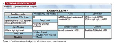

Figure 1. Providing relevant background information spurs correct response. Click here for larger image.

• Operator access to alarm and process knowledge. Alarm design information, including probable causes, potential consequences, recommended corrective actions and guidance on how to confirm the alarm's validity, can improve operators' performance. This knowledge often is locked up in the heads of a few senior operators. In a well-managed alarm system such details are made available to every operator, so each can recognize and correctly respond to process abnormalities faster and more consistently.

Alarms are only effective if operators know how to properly respond to them. So, provide operators with the information documented during rationalization (particularly the cause, consequence, corrective action, confirmation and time to respond). Such "alarm response procedures" can be used for operator training and integrated into the HMI to give operators on-line access, resulting in a quicker and more consistent response.
Ideally, a control system faceplate should offer direct access to appropriate alarm response procedures. Figure 3 shows a setup in which a click on the help icon adjacent to the alarm opened the alarm help window.
