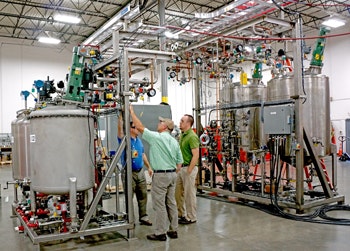

Figure 1. Off-site fabrication can improve the quality of pilot-plant elements and also compress the project schedule.

6. Modular fabrication. First, you must determine if modular fabrication makes sense. Off-site construction at a fabrication facility (Figure 1) helps compress project timeline, ensure quality manufacture inside a controlled environment, and reduce the total number of craftsman hours worked on site, which cuts the chances of accidents.
Shop-fabricated modules offer additional advantages. The controlled fabrication environment means no delays due to inclement weather as well as a higher quality product because every weld is made in ideal conditions. Moreover, it avoids the need for plant personnel to get a general and hot-work permit every day. More of every craft labor hour you’re paying for is spent making progress on your project. This faster installation means less downtime in existing operation units and a speedy return of your facility to making product.
In addition to quality and safety improvements, the schedule compression comes from the ability to concurrently perform any required site work and fabrication as opposed to waiting for the site work to be completed before starting fabrication. Completed skids are fabricated offsite and fully tested, arriving at your plant ready to attach to utilities and come online. (For more on this option, see “Consider Modular Pilot Plant Construction.”)
