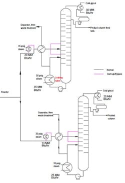

As a process control consultant, I was brought in to fix a blending problem with a set of static mixers installed to replace an agitator ( see figure). The four static mixers are supposed to blend ingredients together before sending them to a feed tank for a packaging line. The liquid ingredients range from 0.3 cP to 250 cP; there’re also some solid ingredients that make up about 1% of the final volume added. The plant hired me specifically to tune the loops for precise control.
According to the production manager and maintenance engineer, the startup with the new controls was a disaster. They were expecting tuning to solve all their problems. They are refusing to pay me.
In confidence, an operator revealed to me that the plant used to blend these ingredients in a baffled agitated tank by batch; the blended stream goes to the feed tank for packaging lines. However, when the agitator gearbox failed, the maintenance engineer reckoned he could save money by abandoning the agitator in place and replacing it with static mixers — despite the quality control manager’s protests that not using the agitator would make achieving six-sigma results hard. It doesn’t help that some ingredients are solids.
The materials that pass through the static mixers go to the feed tank. That small unbaffled tank has a tiny agitator (for the size of the tank); the tank oscillates like a bobble head.
Should I admit I blew it? Should I have investigated the quality control problem a little more before accepting the job? Is there anything else you can recommend to fix this problem?

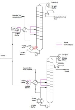

Figure 1. Strong product demand adds to pressure to avoid an emergency shutdown.
January’s Puzzler
The reboiler on our 30-year-old distillation column (Figure 1) finally has failed us; the tubes have been replaced four times. However, we would like to avoid an emergency shutdown and wait until a scheduled outage in a few months. Recently, we added a duplicate second column; we installed that column to allow boil-outs because changes in feedstock caused fouling every quarter year in the old column. Product demand has both columns running as hard as possible. Any suggestions for how we can maintain production? If need be, our other plants may be able to pick up the slack. Should we abandon the old column and rebuild it? I’ve also discovered a second problem: nobody can find the R-stamp report for the first three tubesheet repairs. I ran into a similar problem when I checked some other heat exchangers in these columns: we have the last R-stamp report but we’re missing others. What can be done? Do we need to worry?
