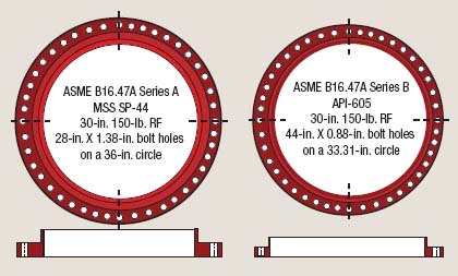

The problem came in assembly. The 30-in. flange on the outlet of the first stage condenser didn't mate up with the 30-in. inlet flange of the condenser. Rush orders were being made to get matching flanges and repairs.
The episode took place well before the American Society of Mechanical Engineers (ASME)  began official efforts in 1980 to develop a uniform flange design for lines with  26 in. and greater diameters. Until then, two different flange standards were common: those of the Manufacturer's Standardization Society (MSS) of the Valve and Fittings Industry, and of the American Petroleum Institute (API). The MSS-44 standard for Steel Pipe Line Flanges radically differed from the API-605 standard for Large-Diameter Carbon Steel Flanges.
Figure 1. ASME standard includes both Series A and Series B flanges.
Figure 1 contrasts the size and bolt layout for Class 150 raised-face flanges. They obviously don't fit up. The ejector manufacturer had used one type of flange and its exchanger supplier had used another.
ASME sought a single unified design for nominal pipe size 26-in. to 48-in. flanges. Either MSS or API or both would have to change to create this standard. Neither would budge. So, today we have an ASME/ANSI standard that has two subsections. ASME B16.47 includes both a Series A equivalent to the MSS flanges and a Series B equivalent to the API flanges. For Class 150 and Class 300 (all sizes) and 36 in. and smaller in classes higher than Class 300, the Series A and Series B flanges aren't compatible.
So while our problem occurred before the ASME standard existed, having a single standard hasn't eliminated the issue. Occasional mismatches continue because of failure to correctly specify Series A or Series B. Few engineers appreciate that two potential flange types are available in large diameters. When you need a large-diameter flange, check what you have and make sure that's what you are going to get.
