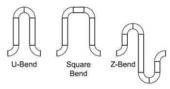

Pipe Loops
Figure 1. These three configurations often are used to accommodate thermal expansion.
Loops give pipe some freedom to move and grow when heated. Figure 1 shows three of several possible configurations —the u-bend, square bend, and z-bend. If the pipe must change direction anyway, careful pipe layout may accommodate the required growth.
