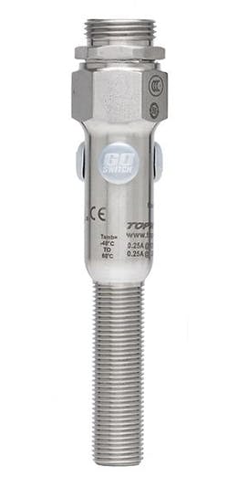

Emerson introduces the TopWorx GO Switch 7LY proximity sensor featuring ultra-bright, easy-to-see light-emitting diodes (LEDs) for highly visible position indication in bright sunlight. The new barrel-style sensor makes diagnostics and troubleshooting easier in challenging environments and hazardous locations, according to the company.
The GO Switch 7LY sensor’s highly visible, dual LEDs provide visual confirmation that the device is getting power and that the switch is accurately sensing. The product’s hazardous area certifications and ability to withstand temporary submersion make it ideal for applications in process industries such as oil and gas, petrochemicals, refineries, mining, water and wastewater.
Emerson’s new GO Switch offering gives process designers the flexibility to use the same sensor in various applications without having to specify different models. The sensor’s polarity insensitivity eliminates the need to specify NPN or PNP products. Its simple contact arrangement makes it easier to install. A stainless-steel sensing face allows for additional robustness and reliability, and its certifications for Class I, Division 2, Groups A-D; Class II, Division 2, Groups E-G; and Class III permit flexibility in selection.
