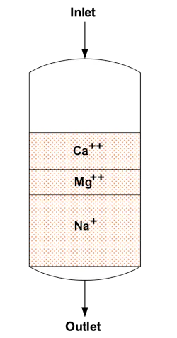

The resin exhibits ion selectivity, as shown for hardness in Figure 6.
The layers expand in depth during operation, and if the bed is allowed to reach complete exhaustion, hardness will begin to appear in the effluent. I once worked at a chemical plant where a critical process relied on sodium softened water. Even minor calcium concentrations would impact the manufacturing process, so we installed an on-line, continuous calcium monitor on the softener effluent line to immediately alert the water treatment staff of upset conditions. Standard operating guidelines called for operation to a throughput volume that reasonably approached but did not threaten bed exhaustion. The continuous monitor provided an extra layer of protection.

Per the reaction arrows shown in Figure 5 and the stratification zones in Figure 6, the resin’s active sites have a much stronger affinity for other cations, and especially multivalent cations such as Ca2+ and Mg2+, than sodium. Ion exchange is an equilibrium reaction, which, during normal operation, is oriented strongly to the right. In accordance with Le Chatelier’s Principle, treatment of the resin with a concentrated brine solution is needed to drive the reaction to the left and remove accumulated hardness and other ions. These exit with the waste regenerant stream. The following steps outline the overall regeneration process.
