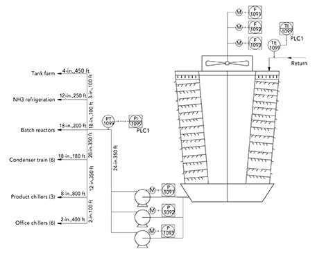

We’re in the dead of summer — the ambient temperature is already 95°F at 90% relative humidity — and our cooling tower (Figure 1) can’t cope. We must run at 50% capacity because we can’t keep the batch temperature in range; we’ve offset the process to make product when the ambient temperature is down, such as at night. The condenser on the ammonia refrigeration runs at far above normal temperature, raising the upper system pressure to near the equipment limit of 400 psig. Last week, we blew the relief on the raw materials cooler; on inspection, I saw that the seals on the delivery pump of a cooled product were blown, adding to our troubles. This inspired me to review the entire cooling tower system.
Current Cooling Tower
Figure 1. Unit can’t cope with summer conditions experienced by the plant, hobbling production.
Here’s what I discovered: 1) when we pulled the heads off the ammonia condenser, we found it full of assorted muck including tree seedlings and mud; 2) two office chillers replaced early this year never were inspected before they were removed; 3) we pulled the head on one of the distillation column condensers — the smallest one, at the end of the train — and found no fouling; relief valves have popped on the product cooler because of high vapor pressure.
The maintenance engineer strongly believes that one fouled head is no problem. Production wants inspections of the heads of all the exchangers as part of every outage. The project engineer thinks we should add cooling towers but install them to serve the ammonia system exclusively, allowing the reactors and condenser to consume most of the cooling water. Another engineer suggested inspecting more condenser heads and, if needed, installing a filtration system at the discharge of the cooling tower pumps. The instrument engineer recommends automating the cooling tower to increase the cooling and system pressure, thereby improving cooling throughout the system.
Do you think we’re in trouble? What’s the best bang for our buck?
