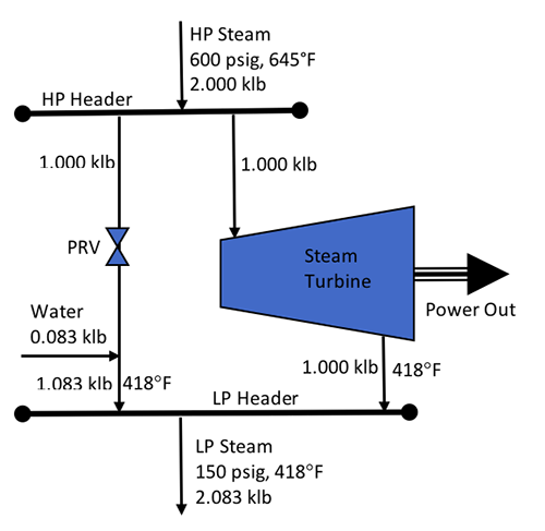

Figure 1. Steam passes through a pressure reducing valve in parallel with the turbine to offset electricity imported from the grid.
Most large chemical plants and oil refineries use steam turbines in a simple form of cogeneration (“Double Up on Cogeneration,” May 2020). High-pressure (HP) steam enters a turbine. Passage through the turbine reduces it to low-pressure (LP) steam. Some of the thermal energy in the steam is converted into mechanical energy, which can be used either to drive process equipment (a pump or a compressor), or to generate electricity. The power delivered by turbines offsets electricity that would otherwise come from the grid. This decreases the site’s electric bill, which lowers the effective cost of the LP steam. Typically, some steam also passes through a pressure reducing valve (PRV) in parallel with the turbine, and desuperheating water is added for temperature control (Figure 1).
The following simplified example, based on the material balance in the figure, considers only the two largest cost components — fuel burned in the boiler ($5.00/MMBtu), and imported electricity ($0.05/kWh). We produce HP steam (600 psig, 645°F) from boiler feedwater at 225°F. We need LP steam at 150 psig, 418°F. We created the material balance using additional data from steam tables, based on 2 klb of HP steam, split equally between a steam turbine and a PRV. The boiler fires 1,316 Btu of fuel/lb of HP steam produced. The steam turbine/generator produces 25 kWh of electricity per klb of steam. The desuperheater requires 0.083 klb of water per klb of incoming steam.
Based on this information, Table 1 shows marginal costs and credits.
The LP steam from the turbine is cheaper than the HP steam due to the power credit. However, the marginal cost of the LP steam from the PRV/desuperheater route is also less than the cost of the HP steam — in this case because of the additional flow due to the desuperheating water. This fact often is missed; it can lead to significant errors when calculating the value of steam savings.
