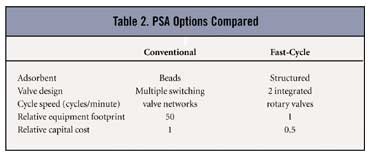

Enter fast-cycle PSA, a technology that operates at cycle speeds of 100 cycles per minute or greater, significantly faster than conventional PSA.
Now in precommercial development, fast-cycle PSA promises to significantly reduce the size and capital cost of PSA equipment, opening up new applications in a wide range of industries. As an example, prototype fast-cycle PSA systems for purifying 100 Nmch (3,500 scfh) of hydrogen are up to one-fiftieth the size of conventional PSA systems, and cost less than 50 percent as much.

Fast cycle speed, together with the high mass transfer and high surface area of the structured adsorbent results in a significant increase in the productivity of a unit volume of PSA adsorbent bed. Increased productivity, in turn, results in a direct reduction in the size of adsorbent beds required to produce a fixed flow of purified product gas (Fig. 3).
Figure 3. Super-Size Reduction Cycle PSA
Fast-cycle PSA modules can be up to one-fiftieth the size of traditional PSA modules.

The multiport rotary valves are capable of efficient switching of gases between adsorbent beds to match the fast cycling capability of the structured adsorbent. The rotary valves also allow for the design of highly efficient complex PSA cycles; and fast cycle PSA systems with 6 to 36 individual adsorbent beds have been demonstrated to date. Multibed fast-cycle PSA systems can be efficiently packaged in an integrated, modular rotating bed design. The fast cycle speed and multibed design produces a uniform flow of product and exhaust gas, removing the necessity for large surge tanks on the product and exhaust streams.
The net result of fast-cycle PSA technology: Large field-erected PSA systems made up of multiple vessels of beaded adsorbent, complex process piping and multiple switching valves can be replaced with integrated fast-cycle PSA modules that are one-fiftieth the size of an equivalent PSA production unit (Fig. 3).
In addition, no exotic materials are used in the adsorbent structure or rotary valve designs, which means that materials costs are minimized. Additional benefits include:
