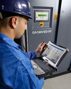

Compressed Air Efficiency Measurement
Figure 1. Free compressed-air-system health checks can pinpoint improvement opportunities.
Water, electricity and fuels such as natural gas are critical components for plant operation and their basic costs are out of your control. However, you can control the cost of the often forgotten fourth utility, compressed air, which is just as critical to production.
Some estimates indicate that poorly designed and maintained compressed air systems in the U.S. waste up to $3.2 billion in energy every year. A careful review of your compressed air system likely will reveal multiple opportunities to reduce energy draw and, thus, dramatically lower operating costs.
As one of the Top 100 global sustainable companies, Atlas Copco knows firsthand how to maximize production and lower energy usage during manufacturing. The company shares this knowledge in various ways. Our service team provides free compressed-air-system health checks that can help a plant’s technical staff recognize areas where improvements are possible (Figure 1). We also offer a free 156-p. “Compressed Air Best Practices Guide.” (For a copy e-mail [email protected]. Put “Manual — Chemical Processing” in the subject line and include your mailing address in the body of the e-mail.)
