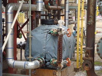

Steam Pump
Figure 1. Unit only operates when triggered by condensate level.

Seeking a lower cost and a more dependable solution, the refinery was drawn to the simplicity of Armstrong's PT-516 pump (Figure 1). It uses steam from the plant rather than electrical power. And, unlike the centrifugal pumps that ran continuously, the PT-516 only consumes steam when the condensate level in the pump requires a pumping cycle. The refinery reports there no longer are any NPSH concerns and hotter condensate (212°F versus 180°F) now can be returned. The steam-driven pump can handle up to 65,000 lb/hr of condensate.
The pump plus accessories and check valves cost about $20,000. Installation also involved removal of unneeded piping, controls and valves. The payback period should run two to three years.
The Armstrong PT-516 steam pump has been in service for more than a year with no interruptions to returning condensate from the crude unit to the boiler house. This has helped the refinery maximize energy savings and capture an additional $75,000 annually.
