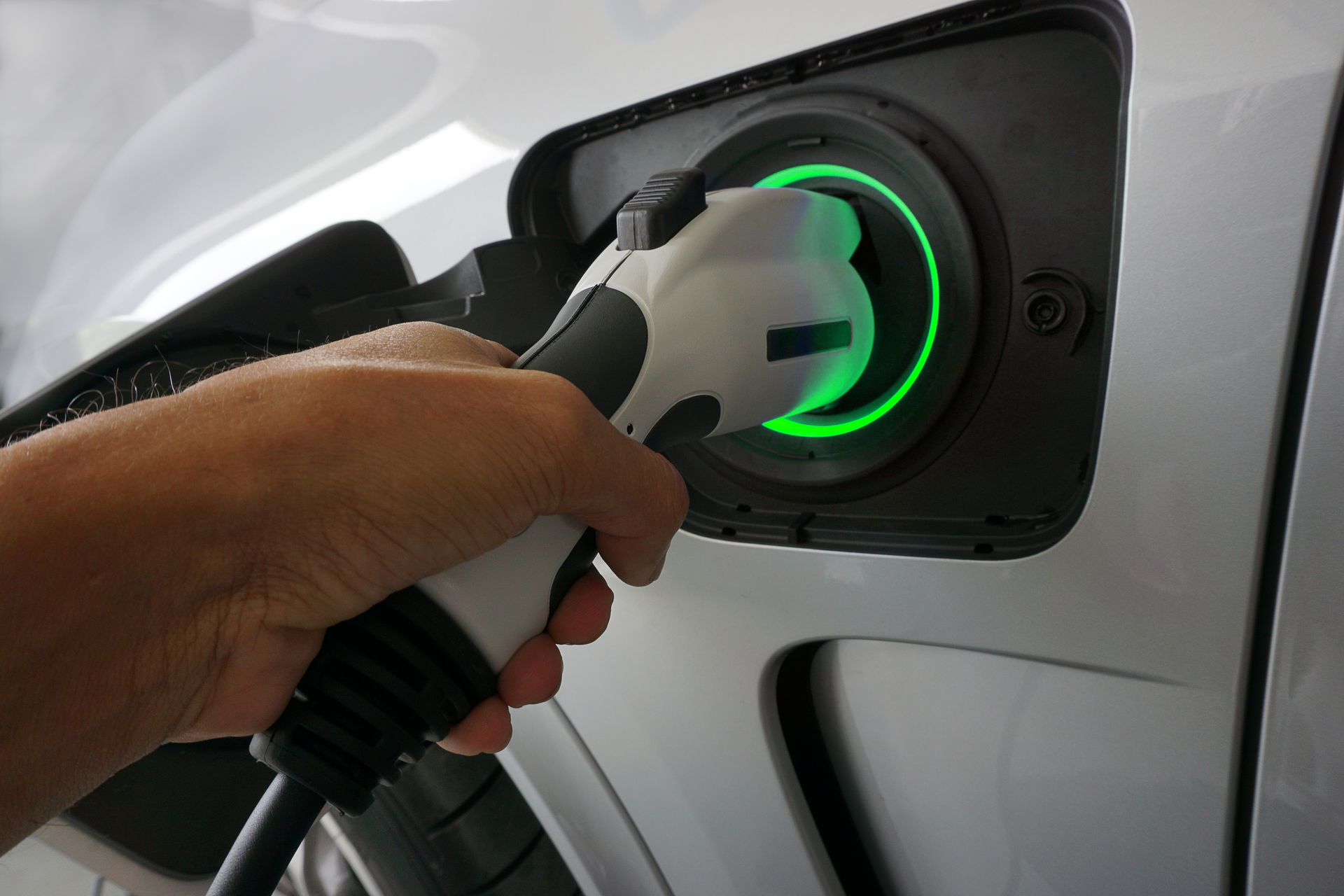

One of my friends — a lawyer — was the first person in our neighborhood to buy a Tesla. I admired the car, and he gave me a test ride, which impressed me even more. Then he told me how amazingly efficient the vehicle was. That was a dangerous thing to say to an engineer, especially one who specializes in energy efficiency.
I tried to be gentle with him. He was only a lawyer, after all; some electric motors can convert 98% of the incoming electrical energy to useful power. Unfortunately, that is only part of the story.
The power for the motor (98%) comes from a battery (90%), which draws power from a charger (90%), which gets its power from the electric grid (85%), which, in turn, gets its electricity from a power plant (35%). The numbers in parentheses are indicative energy efficiencies of each subsystem within what is actually a very large, cascaded system; the overall system efficiency is 0.98×0.90×0.90×0.85×0.35 ≈ 0.24, or 24%. Suddenly, the electric car doesn’t look so efficient. Note: Actual efficiencies can differ significantly from the indicative values shown above, especially for the power plant, which can use many different technologies and energy sources.
I’m not against electric vehicles. In fact, I now own a plug-in car myself. The point I want to emphasize is that we should consider complete systems, not individual components, when we make decisions about energy use or environmental impact. The “well to wheels” efficiency of a typical gasoline-engine car is calculated from a similar cascade. Its “cascade efficiency” is even lower than that of an electric vehicle.
