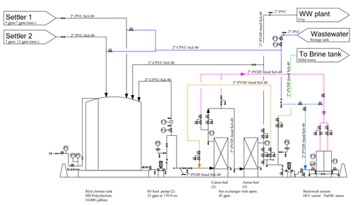

September’s Puzzler
A few months ago, we installed a bank of ion exchange (IX) columns to polish our wastewater before it goes to the city treatment plant. (See Figure 1) We have a plating bath operation where we are trying to reduce the Cr6+ to our allowable limit of 0.08 mg/L; the Safe Drinking Water Act sets a maximum of 0.1 mg/L. We use a sedimentation process upstream of the IX columns to eliminate most of the Cr6+. This sedimentation process worked well except for the surges caused by increased flushing of the baths due to solids’ precipitation. The IX columns performed well for several weeks but then we started seeing problems. We’ve experienced high pressure drops, fouling in our backwash tanks and the loss of the column feed pump once. Moreover, we’ve had to replace our cation IX columns already. The city has heard of our problem and expressed concern about us achieving our allowable Cr6+ limit. Any ideas on what’s going on?
Ion Exchange Process
Figure 1. The relatively new system is suffering from a variety of problems.
Send us your comments, suggestions or solutions for this question by August 12, 2016. We’ll include as many of them as possible in the September 2016 issue and all on ChemicalProcessing.com. Send visuals — a sketch is fine. E-mail us at [email protected] or mail to Process Puzzler, Chemical Processing, 1501 E. Woodfield Rd., Suite 400N, Schaumburg, IL 60173. Fax: (630) 467-1120. Please include your name, title, location and company affiliation in the response.
