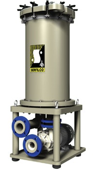

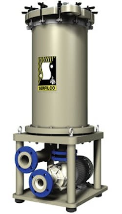

Serfilco's compact Mega-Flo filtration system offers high flow rates from 8,500 to 21,000 GPH. The efficient and durable systems are designed to handle a variety of solutions including electroplating, printed circuit board, water and waste treatment, fume scrubbers, cooling tower reservoirs and more.
Featuring PVC construction for temperatures up to 140 °F or Serfilco's PPP polypropylene construction for applications up to 180 °F,  the systems are available with a single or a double mechanical seal pump or with a magnetic coupled polypropylene pump to meet almost any application.
Oversize ports on the filter chambers result in low pressure differential. This, together with high solids holding capacity, results in long periods of high flow and continuous dirt removal between cartridge changes.
