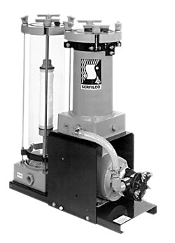

Coalescing System Includes Corrosion-Resistant Features
The coalescer is can separate dissimilar liquids with a specific gravity difference of .09 or greater.
Serfilco offers equipment for coalescing or separation of free oil from aqueous cleaners or other liquids of dissimilar specific gravities. The unit of corrosion resistant, all-plastic construction includes a pre-filter, which extends service life of the coalescing element. A complete line of systems in carbon steel and stainless steel is also available.
The coalescer is can separate dissimilar liquids with a specific gravity difference of .09 or greater. Recovered effluent contains less than 10 ppm of the discontinuous phase. For some combinations of liquids, the effluent contains less than 5 ppm of contamination.
When used on pre-treatment systems ahead of finishing operations, the coalescer can extend life, improve performance, and prevent contamination of subsequent processes.
