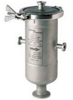

Spirax Sarco has released the CS10 clean steam separator with an enhanced surface finish as standard. The separator has been engineered to overcome problems associated with wet steam and ensure the correct quality of steam is supplied to the point of use, preventing damage to control valves and inability to meet steam sterilization requirements.
Constructed of 316L stainless steel, the CS10 is fully traceable, ensuring steam integrity. It has been designed to exceed the steam dryness value of 0.95 and features a removable internal baffle to facilitate periodic de-rouging and inspection. The CS10 is engineered in accordance with the latest standard of ASME BPE guide for the biopharmaceutical, food and medical industries. All elastomers are FDA regulation CFR 21, paragraph 177, section 2600 and USP class VI.
