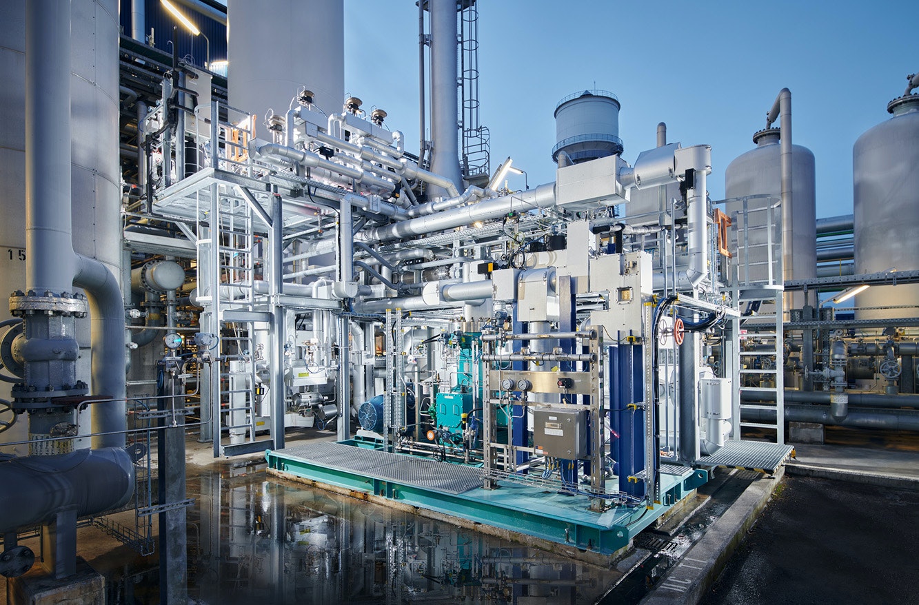

The full-scale plant at Linde’s production site in Dormagen, Germany, features Linde’s Hiselect powered by Evonik membrane technology to extract hydrogen from natural gas pipelines.

Linde Engineering says it has officially started up the world’s first full-scale pilot plant in Dormagen to showcase how hydrogen can be separated from natural gas streams using Linde’s Hiselect powered by Evonik membrane technology. The process enables scenarios in which hydrogen is blended with natural gas and transported via natural gas pipelines, according to the company. The blended gas could consist of between 5% and 60% hydrogen. Membranes then extract hydrogen from these natural gas streams at the point of consumption. The resulting hydrogen reportedly has a concentration level of up to 90%. When further processed with Linde Engineering’s pressure swing adsorption (PSA) technology, a purity of up to 99.9999% is achievable, according to the company.
