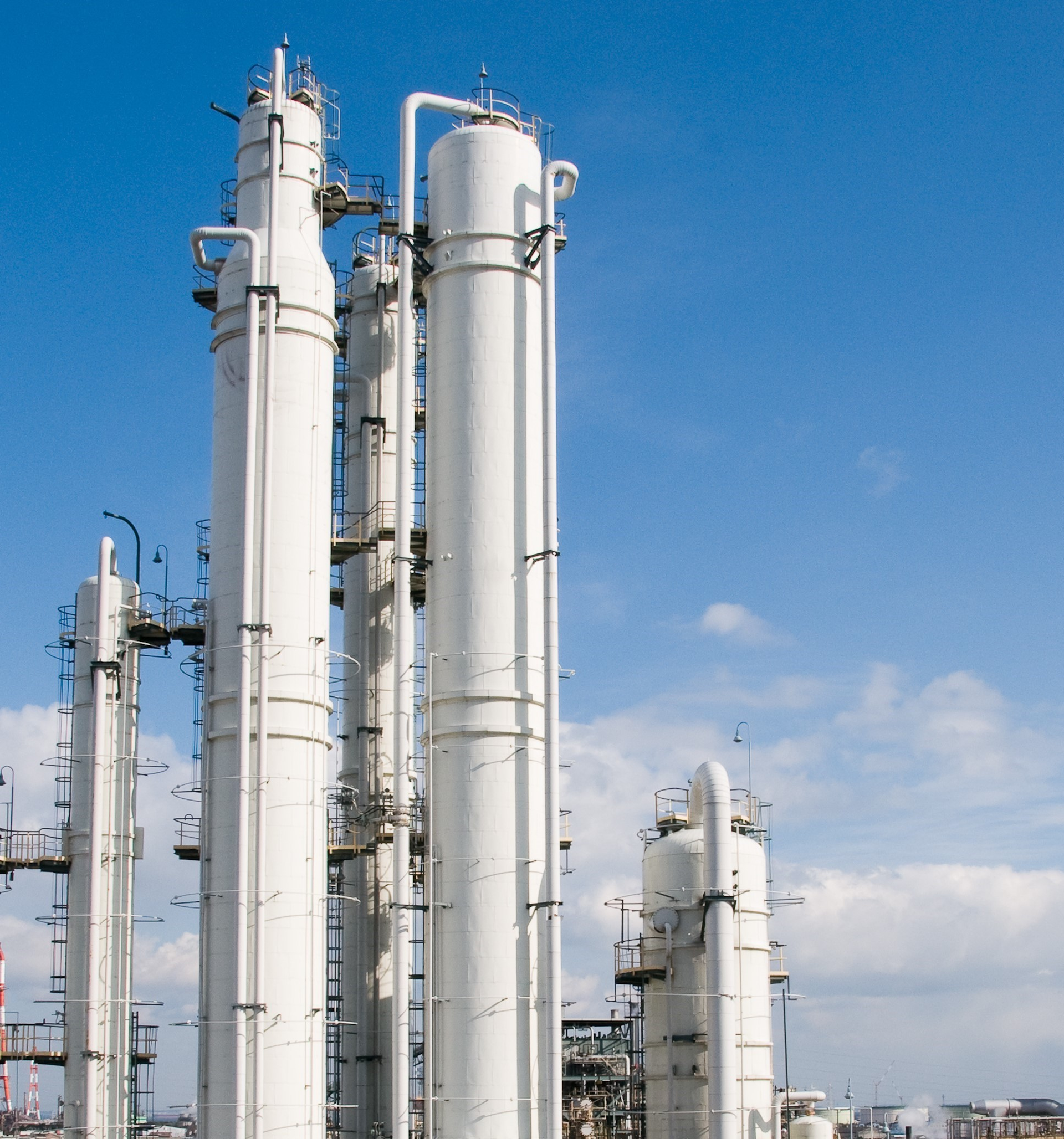

Autonomous process control in chemical manufacturing has passed a major milestone with a new installation for a distillation process. The Eneos Materials Corp. plant in Japan needed to regulate a distillation column (lead image) that the company couldn’t fully automate using conventional proportional, integral, derivative loops – or even advanced process control strategies. Instead, operators had to manually control critical valves to regulate liquid levels in the column trays to maintain production specifications. The lack of automation also meant the plant couldn’t maximize cost savings from using waste heat in the process.
Eneos turned to artificial intelligence (AI) to overcome several challenges in the distillation process, including:
• The critical product and byproduct were difficult to separate due to their similar boiling points.
• A conventional boiler heats the column. The plant captures waste heat from other processes to reduce cost and improve sustainability, but waste heat supply is variable. Operators must balance the two types of sources.
• The plant is located in an area with varying weather patterns, including daily temperature fluctuations and rain, which can change column conditions.
• The plant needed precise control of temperature, bottom levels and yield to ensure product streams from the tower met specifications.
