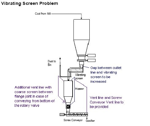

I’m not sure how to resolve the problem with the dust but have some thoughts on avoiding plugging in the coal. I believe the symptoms can be solved by adding some additional lines. The following problem being faced in the system: the feed line to vibrating screen is getting choked; the material isn’t sufficiently flowing to screw conveyor; and, sometimes the line to screw conveyor is getting plugged.
Figure 3 describes the changes that I recommend. There are several solutions that should be considered separately.
Figure 3. Flow is blocked at discharge of vibrating screen.
To avoid choking of feed line to vibrating screen, the gap between line and screen should be increased. If there is a cloth bellow at the end of the pipe, its length should be reduced so that there will be sufficient gap between it and the screen.
The counter weights of the motor of the screen should be adjusted to increase the vibration in horizontal and/or vertical direction. It may be that the vibration motion is inadequate for the task.
To avoid air-locking of the rotary valve, a vent line should be installed connecting the rotary valve vent port with the top of the feed hopper. This line is shown in the drawing. Take care with this line that there is sufficient slope to avoid build-up of solids. Piping should be flanged, not welded, for ease of disassembly. Adding view-ports to such lines might be useful. Size the vent line based on the volume discharge rate for the rotary air lock.
Watch the process after making these improvements. If the problems remain, an additional vent line can be provided with a removable screen. This line will vent only air and solid won’t plug the line. Piping should be designed for disassembly. Use the leakage rate for the rotary valve for sizing. To avoid plugging of the feed line to screw conveyor, add a vent line to the screw conveyor connecting it to the feed hopper; the cross-sectional area of the vent line for screw conveyor should be the same as the area for the screened line.
If these pipe changes don’t effect an improvement, consider re-evaluating your equipment choices.
