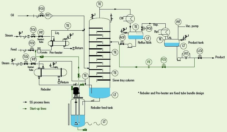

Question from June's Chemical Processing
Our fractionating column is notorious for its problems. Oil is injected into heated feed to separate an impurity. This approach eliminates the impurity well, perhaps too well. A sludge collects in the bottom of the reboiler feed tank, clogs the sieve column and plugs the reboiler and pre-heater. There’s some concern that separation efficiency is affected by plugging of the trays but the main problem is frequent fouling of the heaters, which have fixed heads and are difficult to bore out. The reboiler pump fails often and we must call in a vacuum truck frequently and unexpectedly to clean out the reboiler feed tank. Start-up is often a problem because the steam plant is far away. The oil frequently burns, which adds to our fouling woes. What can you recommend to reduce sludge build-up in the trays, heaters and reboiler feed tank?

Install basket filters
First, fire the chemist who suggested using oil to remove impurities. Second, demote the plant manager who acceded to this nutty idea. Third, while you’re looking for a better impurity remover, install three or four basket filters (you get to pick the mesh size and the basket size), each manifolded to the “bottoms” and leading back to the reboiler feed tank.

Consider three options
It seems like the problem is that we’ve introduced a non-volatile component into a distillation system and that the component is collecting in the low spot of the system over time. Once it builds up enough, the pump sucks it in and then distributes it to the heat exchangers.
I would propose several solutions to this problem:
  1. Does the oil need to enter the fractionating system or can it be removed in the feed prior to the column? From the description, the impurity combines with the oil to create a sludge that’s denser than the feed or the bottoms product, so perhaps install an extraction system in the feed line downstream of the mixing point that could be as simple as a holding tank that allows the sludge to drop out of suspension and collect in the bottom of the tank. The tank could then be sucked out periodically as necessary to remove the impurity or, if possible, the oil could be filtered and recycled in the process. This would be capital intensive but solves the column problems, exchanger problems, pump problems, and start up problems. It also limits operator involvement if potential exposure to the process fluids is unacceptable.
  2. Run the reboiler feed tank at a higher level and shorten the suction line of the reboiler pump. Automate the drain or make it standard operating procedure to drain the bottoms of the reboiler tank periodically to remove the sludge from the system before it wipes out the pump and fouls the exchangers. This solution is almost capital-free but the oil still enters the column and there’s a good chance for an upset that would introduce the sludge into the heater system. During start-up you could establish levels with oil-free feed since the column is on total reflux and then introduce the oil after establishing stable bottoms levels. The drawing doesn’t show the bottoms draw on the column so it’s unclear what effect the impurity would have on this part of the column.
  3. Install a side-stream filter system utilizing the differential pressure across the reboiler pump that will remove over time the sludge that’s present in the column bottoms, similar to a side-stream filter in a cooling tower/jacket water line. The column will still see the full amount of the oil and the pump will see a small portion of the sludge but probably not enough to affect the reliability of the pump to a major extent. This solution requires some capital but is probably less prone to upsets than option 2. Again, during start-up you could establish levels with oil-free feed. This would potentially expose operators to process chemicals during the filter change outs, so it may not be acceptable.

Pull a vacuum
Perhaps the impurity could be removed in the fractionation column without adding the oil if the column were operated under a vacuum (or a lower vacuum if it’s under vacuum now). Depending on the chemicals involved, deeper vacuum would require lower heat input to cause the fractionation. The statement “oil frequently burns” indicates a high temperature of operation. Lower operating temperatures would help lower or eliminate that. The impurity may have a different boiling point at a lower pressure and eliminate the need to add oil to separate it.

What really is the problem?
You could have any one of a combination of problems. The response and possible improvements depend upon the specific problem you have. I’m assuming that the “heavy oil” goes overhead and the contaminant goes bottoms for the most part. A partial list of possibilities include:

Solids contamination. Solids entering the process will go somewhere and they will go down. If you are putting solids in the process your choices are simple: remove them upstream, remove them in the process or remove them downstream. Have you considered a wiped-film evaporator on the heavy oil feed? This would eliminate the solids and send a vapor stream to the tower. Once the solids enter the tower the best you can do is keep them moving. Electropolish the trays; install fixed, directional valve trays with large openings; and make sure the tray flow patterns don’t have dead spots. This moves the solids to the tower bottoms and exchangers.
Some towers have successfully used trash collectors on a bottom tray sump or other locations to keep solids out of the reboilers and bottoms pumps, with manholes or handholes to ease cleaning. Once the solids get past the tower bottoms they’ll end up in the reboilers and bottoms pumps. At that point, you need to have bundles that are easy to clean.
From your description, it sounds like you have the tower side (process service) in the tubes. I don’t see any simple solutions to improving exchanger performance here. Polishing the tubes to prevent sticking may help but the solids still go somewhere. The soundest approach to preventing reboiler problems is probably reboiler replacement. Helical baffle and spiral-plate exchangers as well as conventional non-fixed-head exchangers may all be good choices. Reboiler pumps also lack clear solutions. Solid crusher pumps are available if your pressure and temperature are in the correct ranges. Filters installed between the tower and pump may help but be careful of pump NPSH. Once filters are installed you need to clean them as well.

Switch to jet trays
In the one of our towers we contracted the same problem and during one year plugged all holes of trays with hydrocarbon and hole diameters were reduced from 13 mm to 5 mm. We replaced all of the trays with jet type. Now that tower has been in service for two years and we haven’t seen increasing pressure drop or other issues.
If space is sufficient in the bottom of tower, it may make sense to install a baffle and collect sludge on one side and clean fluid to go to reboiler on the other side.

Look at the exchangers and pre-heater
There are two classes of problems I can discern from the puzzle description: operating difficulties and maintenance issues. Of the two, the easiest to solve are those involving maintenance. Let’s consider maintenance first. The first problem is the choice in heat exchangers.
These appear to be TEMA Class BEM units, which are difficult to maintain and do not belong where steam is used. B-E-M stands for integral bonnet cover (B) with a single shell pass (E) and a fixed tube-sheet (M). As a rule of thumb, allowance should be made for thermal expansion where the temperature difference between the tube-side and shell-side fluids is greater than 70°F (39°C). This has been stretched to 100°F but it is better to err on the conservative side.

Now, let’s look at the process problems. Clearly, the oil is doing its job. The impurity is being removed but the process is not designed to handle the quantity of solids collected in the reboiler feed tank. The evidence of a problem with solids is the way a control engineer chose to measure level in the reboiler feed tank: a nuclear level transmitter. This method is a favored choice when sludge build-up rules out most other modes.
Measuring the solid is easier than managing it. Years ago, when a similar situation came up I suggested an automated strainer; my boss went with a suction strainer. With the suction strainer, which was an integral part of the pump, the reboiler pump had to be replaced and up-sized. The automatic strainer provided some of its own pressure so it was debatable whether the reboiler pump needed to be replaced. Mechanical reliability was in doubt with the discharge strainer because of the severe corrosion.
