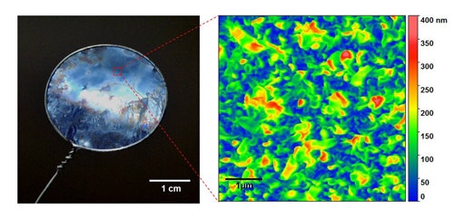

Figure 1. Tiny crumples and ridging at the nanoscale help filter organic liquids under extreme pressures. Source: Santanu Karan, Imperial College London.

The crumples on the polyamide nanofilm increase surface area for filtering substances. The membrane remains strong and resists buckling even at extreme pressures; it can filter organic liquids at 50 bar. Moreover, the membrane can withstand a range of organic solvents.
