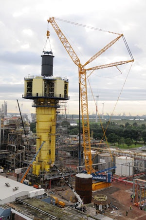

Modified Column
Figure 1. Adding a section to a column may enable incorporating desired new internals. Source: Sulzer.

Occasionally, a column is just too small to cope with the new internals. Sometimes, adding a new section is the answer (Figure 1), he notes.
