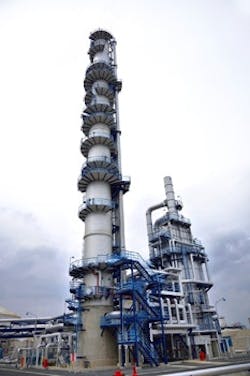

Dividing Wall Column
Figure 1. Unit for separating mixed xylenes now has been operating at Japanese refinery for over a year.
As energy sectors enter a phase emphasizing energy reduction, interest is growing in dividing wall column (DWC) technology for distillation. For example, a recent installation took place at a refinery complex in Chiba, Japan, owned by the TonenGeneral Group. There, the DWC recovers 230,000 t/y of high-purity mixed xylenes from a full-range reformate feed.
The project was implemented in early 2016 with the intention of rejuvenating petrochemical business in Japan. Mixed xylenes, along with other heavier components, traditionally had been used as gasoline base stock in the refinery. However, to improve profitability, TonenGeneral decided to separate the mixed xylenes. The DWC (Figure 1), which has a processing capacity of 1,170 bbl/d, has been fully operational since April 2016. It recovers 98.5% of mixed xylenes (C8 aromatics) contained in the feed.
Opting for the DWC instead of a traditional distillation column for the separation provided significant savings: 19% in capital cost and 20% in utilities.

The column has a diameter of 4 m and is approximately 80 m in height. Its large dimensions necessitated transporting the column in three parts, each 25–30-m long, and assembling them together on site.
