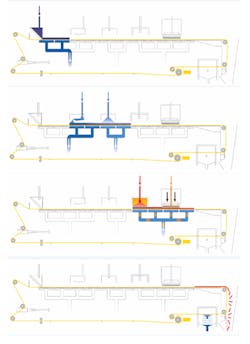

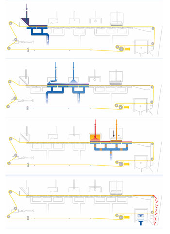

Schematic Operation Of Filter
Figure 1. Technology, based on fixed vacuum trays, features step-wise movement of filter media.

The BHS continuous-indexing vacuum belt filter provides for vacuum filtration, cake washing, pressing and drying of high solids slurries. The technology is based upon fixed vacuum trays, a continuously feeding slurry system and indexing or step-wise movement of the filter media (Figure 1). In practical terms, the belt filter operates similarly to a series of Buchner funnels.
At each indexed belt position, washing and drying efficiencies are maximized with the stopped belt and the mechanism of plug flow for gases and liquids. Cake pressing and squeezing further enhance drying. Finally, the fixed trays allow for the mother liquor and the wash filtrates to be recovered individually and recirculated/recovered/reused for a more efficient operation. The design also can integrate steaming as well as counter-current washing.
