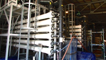

Reverse Osmosis
Figure 1. Use of such a unit for tertiary treatment of wastewater is becoming popular.

This ensures removal of remaining contamination and solids in the wastewater. Such tertiary treatment usually involves filtration systems such as disc filters, reverse osmosis (RO) units (Figure 1), etc. You usually should direct filter reject from backwash or RO unit rejects to the flow distribution chamber upstream of the equalization system; most often, these rejects require a dedicated pumping system. To eliminate specific contaminations to meet regulatory requirements, many plants must resort to special treatment, e.g., the Fenton process to remove non-biodegradable COD. While other technology options are available, the Fenton process most often is selected because of its reliability, initial cost, operational cost and footprint.
