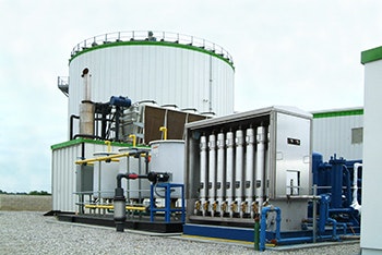

Biogas upgrading is growing in importance, notes John Hoffmann, marketing and business development specialist, Air Products Prism Membranes, St. Louis. “Air Products anticipates that this market will continue to see expansion as economies are committing to carbon-neutral energy policies.”
For example, a consortium is running a demonstration project in Japan that puts farm wastes through biodigestion and separates the biomethane with Prism PB separators (Figure 1); reforming yields hydrogen, which is distributed as “green hydrogen” for vehicle fuel.

Biogas Upgrading Facility
Figure 1. Growing interest in green fuels is making biogas upgrading increasingly important. Source: Air Products.
