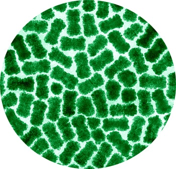

To address this issue, Zubarev and graduate student Bishnu Khanal attached hairlike molecules of polystyrene to the nanorods (Figure 1). The polystyrene shells made the coated particles completely soluble in organic solvents and dramatically enhanced their selectivity. (More details appear in Angewande Chemie International Edition.) A conventional centrifuge can remove the particles easily from solution.

Figure 1. Hybrid materials should offer easier separation from reaction mixtures and greater resistance to poisoning. Source: Rice University.
