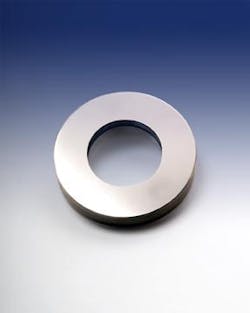

Fused sight glasses combine a metal outer ring with a glass inner core (Figure 3). This combination of materials, when properly executed, creates a super strong sight window for extreme applications. During manufacture, glass is melted inside a metal ring and fuses to the metal. Because the glass and metal have different coefficients of thermal expansion, the glass hardens before the metal ring shrinks back to its original size. This places the ring in tension and the glass in uniform radial compression.
The homogeneous compression offsets the effects of tensile stress. This constant compressive force on the glass greatly increases the sight glass’ resistance to high pressure and physical and thermal shock. In effect, the glass becomes elastic, which is the surprising ability to bend without breaking. Taken to an extreme, the outside glass may crack but the subsurface glass, which still is under compressive force, will retain its integrity.
Sight Glass Window
Figure 3. This design fuses glass to a metal frame and maximizes compression of the glass.
The design challenge is to combine metal and glass types to maximize the compression on the glass without exceeding a point where the glass will shatter. Sight glass manufacturers have tried various kinds of glass and different steel alloys. In practice, they only use soda lime glass and borosilicate glass because these provide the optimal coefficients of thermal expansion. Manufacturers employ a variety of metals, including duplex stainless steels, high nickel alloys and carbon steel. Type-316 stainless steel isn’t recommended because its coefficient of thermal expansion is too high and will crack the glass. The difference in the thermal coefficients of expansion of the materials used enables prediction of the amount of compression.
Borosilicate glass has a lower coefficient of expansion than soda lime glass and, thus, causes higher levels of compression inside the metal ring. A paper by Karl Schuller of Herberts Industrieglas GmbH concluded that fusing borosilicate glass creates 2.8 times more compression than fusing soda lime glass. This higher compression increases the maximum operating pressure of a fused borosilicate sight glass 4.5 times. Therefore, fused borosilicate sight glasses are much stronger than fused sight glasses made with ordinary soda lime glass (Figure 4).
