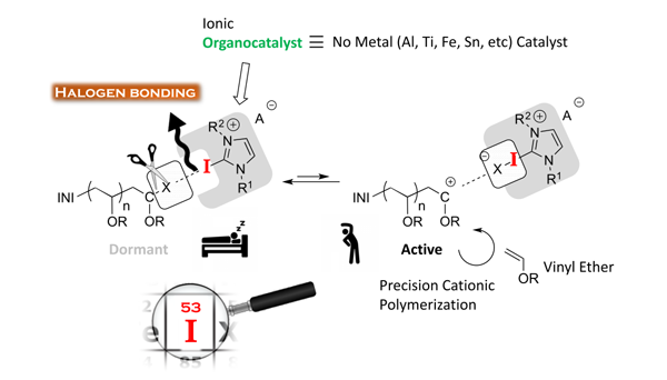

Figure 1. Method yields polyvinyl ether with predictable molecular weight and narrow molecular weight distribution. Source: Nagoya Institute of Technology.

Takagi and his coworkers developed a metal-free process for controlled cationic polymerization of isobutyl vinyl ether (IBVE) mediated by hydrogen bonding (Figure 1). It uses a halogen initiator together with an ionic organocatalyst. The catalyst abstracts from the initiator an anion that reversibly interacts with the catalyst and the propagating end of the polymer. Weak bonding is preferable to avoid side effects that might compromise the homogeneity and size of the resultant polymers. The researchers found that chloride forms appropriately weak halogen bonds with a 2-iodoimidazolium catalyst for polymerizing IBVE.
The chloride anion efficiently could shift back and forth between the catalyst and the propagating end of the IBVE, yielding a polymer with a high molecular weight and a narrow molecular weight distribution. Operating at a temperature of -10°C and with 10-mM concentrations for each element of the initiating system minimized deleterious side effects, say the researchers.
